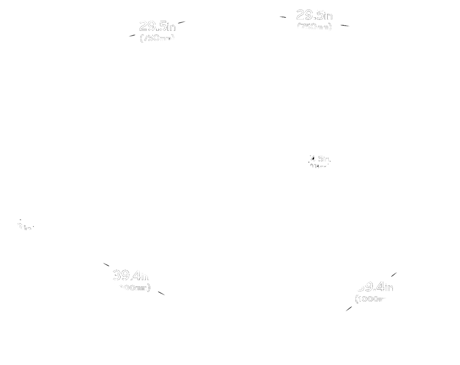

Diagram
  • Work Area: 29.5in x 29.5in x 4.5in
  • Machine Footprint: 41 in x 52 in x 22 in
  • Maximum Passthrough Sheet Width: 37in
  • Weight: Approx 100lbs
