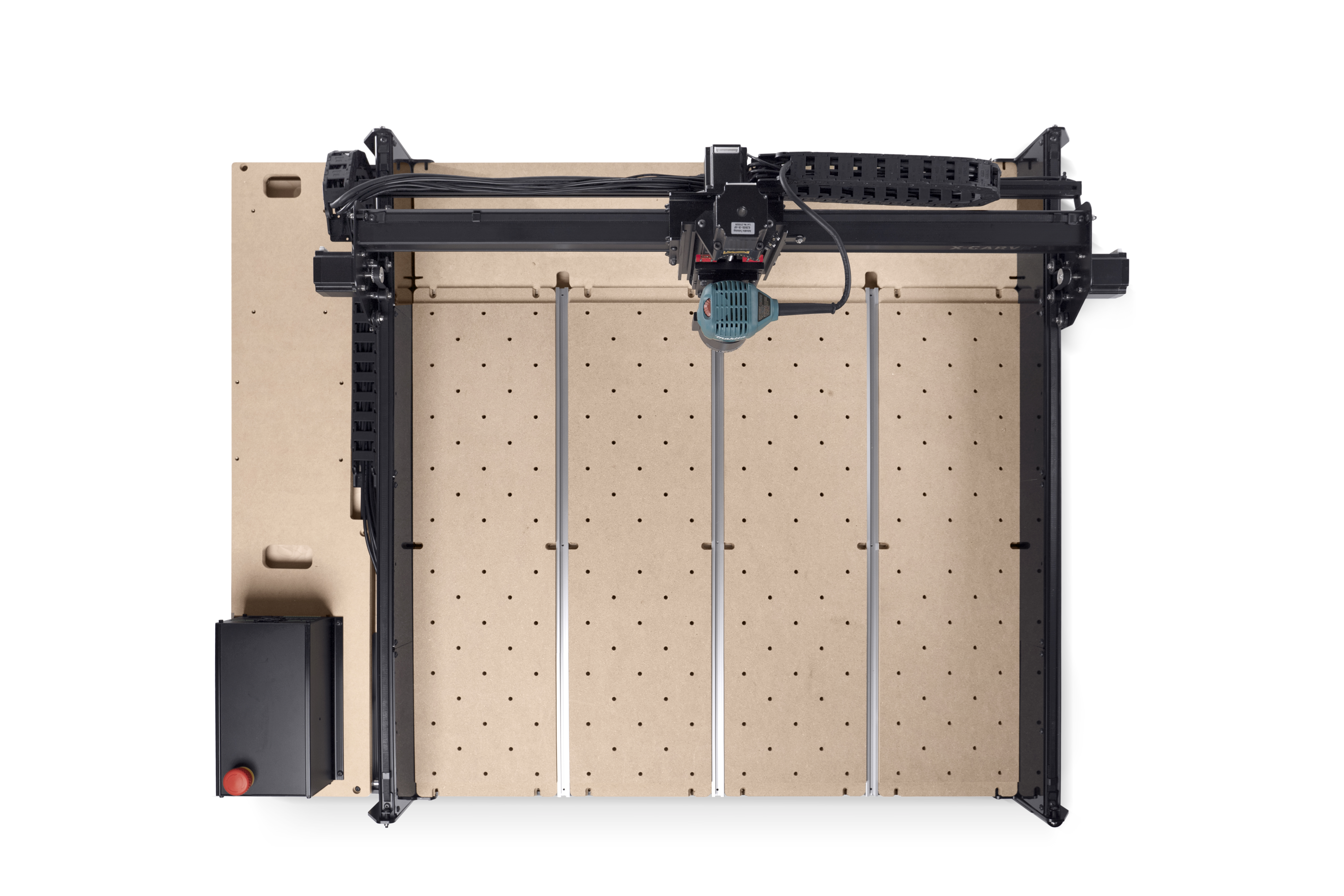

X-CARVE
  • Who is it optimized for?
    Great for Makers looking to start their CNC journey
  • What types of products do people make with this?
    Small Signs, Home Decor, Art
  • Cutting Area
    29.5 in. x 29.5 in.
  • Weight
    ~100 lbs.
  • Gantry
    Belt drive with Delrin V-wheels X and Y
    Precision linear bearings with acme leadscrew Z
  • Spindle
    1.25hp (800W)
    Makita router
  • Spindle RPM Range
    10,000-30,000 RPM
  • Accuracy
    ~.005 in.
  • Assembly Time
    16-18 hrs.
  • Materials it can cut
    Wood/Wood Composites:  Hardwoods, softwoods, MDF, plywoods, etc.
    Plastics:  HDPE, Delrin®, polycarbonate, acrylic, Corian®, etc.
    Non-ferrous metals:  Aluminum, brass, copper, etc.
  • Support
    US-based support team available by email and by phone M-F, 9am-5pm CST
  • Software
    Options for 1 yrs or 3 yrs. of Easel Pro CAD/CAM CNC Software
  • Warranty
    6 month limited warranty included
  • Price
    $1,395

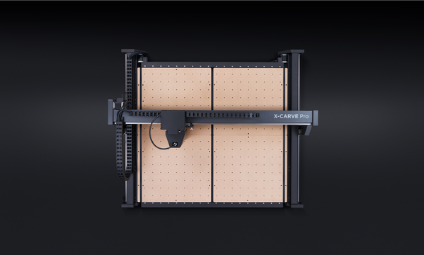

X-CARVE PRO
    Aspiring and established business professionals seeking to scale production
    Furniture, Cabinets, Built-Ins, Large Signs
  • Cutting Area
    48 in. x 48 in or 48 in. x 24 in
  • Weight
    ~300 lbs.
  • Gantry
    High-precision 25mm ball screws on X and Y axes
    linear guides on all axes, 2x on X and Z axes
  • Spindle
    2hp (1,500W) spindle run by a pre-programmed VFD
  • Spindle RPM Range
    8,000-24,000 RPM
  • Accuracy
    ~.001 in.
  • Assembly Time
    2 hrs. (Gantry is pre-assembled and factory calibrated)
  • Support
  • Software
    Select between 3 yrs. or 1yr of Easel Pro CAD/CAM CNC Software when you add to cart
  • Warranty
    1 year limited warranty included
    optional 3-year extended warranty available
  • Price
    $4,250 - $5,995
